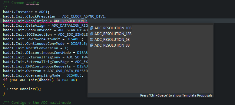

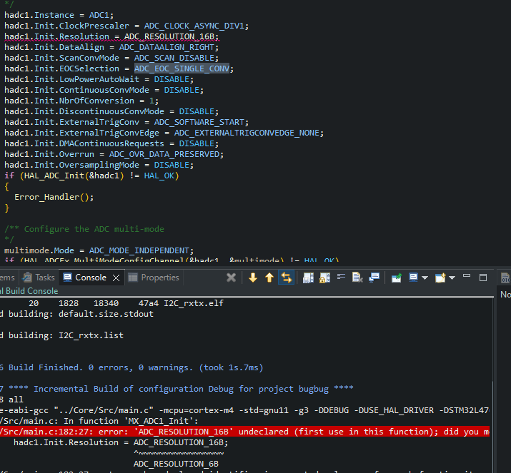

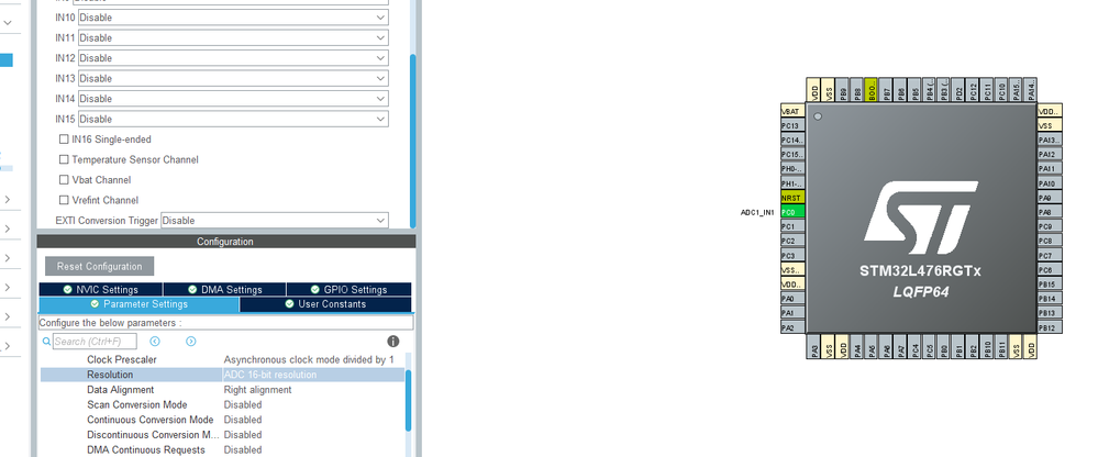

I notice that CubeMx allow choose 16-bit resolution but STM32L476 has range from 6 to 12 bit.
When I generate code I can't compile it:

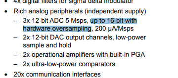

Moreover in datasheet we read on page 1:
but it's only one information about mystic 16-bit resolution :D

Pleas look at my first post. CubeMx generate ADC_RESOLUTION_16B that not exist in ADC header for this board .

Well, we are talking about a 12-bit ADC with hardware oversampling.
In the generated code you will find at the very bottom: hadc1.Init.OversamplingMode = DISABLE;, which is set by the CubeMX setting in "ADC_Regular_ConversionMode". You will get 16bit oversampling when enabled.
2023-04-28 6:26 AM
Oh, sorry, I hadn't read the post carefully enough. You are right, the option ADC_RESOLUTION_16B must not appear or be selectable here.

Hello All,
Issue confirmed and an internal ticket (ID 150960) is submitted in order to fix this.
(PS: ID 150960 is an internal tracking number and is not accessible or usable by customers).
Thank you for your contribution.
