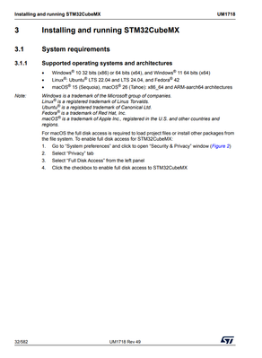

Hello @TheWinds
After checking UM1718
STM32CubeMX 6.16.0 is only tested and supported on specific Linux distributions (like Ubuntu LTS and Fedora).
Arch Linux is not officially supported, so compatibility is not guaranteed.
THX
