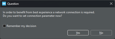

I don't get any pop-ups like the one mentioned in the image even after following steps 1-3.
