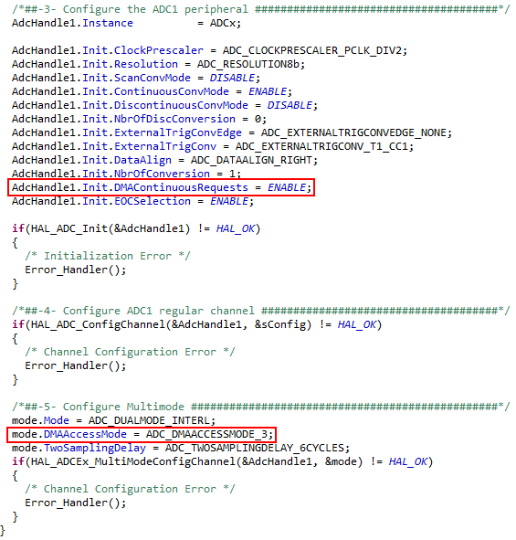

If you switch to a multiple mode (dual or triple), and if it is possible to use the DMA transfer, you have to use the ''DMA Access Mode'' parameter that will be available in the common settings section.
2014-04-03 1:13 AM
STM32Cube_FW_F4_V1.1.0\Projects\STM324x9I_EVAL\Examples\ADC\ADC_DualModeInterleaved\Src\main.c

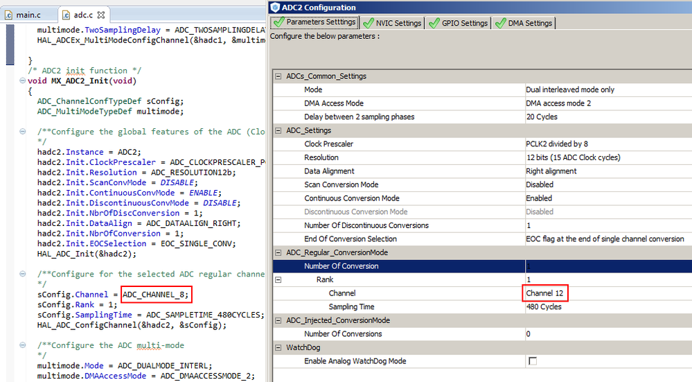

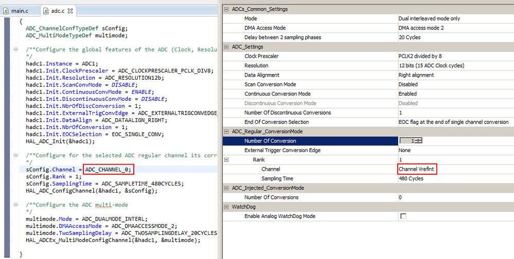

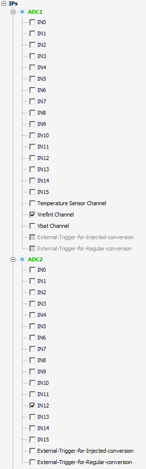

In version 4.1.0 you broke change ADC channels, changes are not saved. (saved, but they differ sorce code.)
