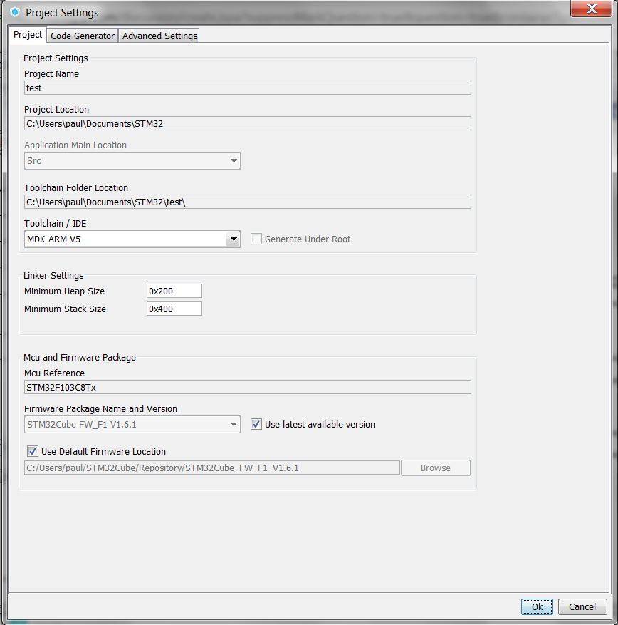

Here is my setup:

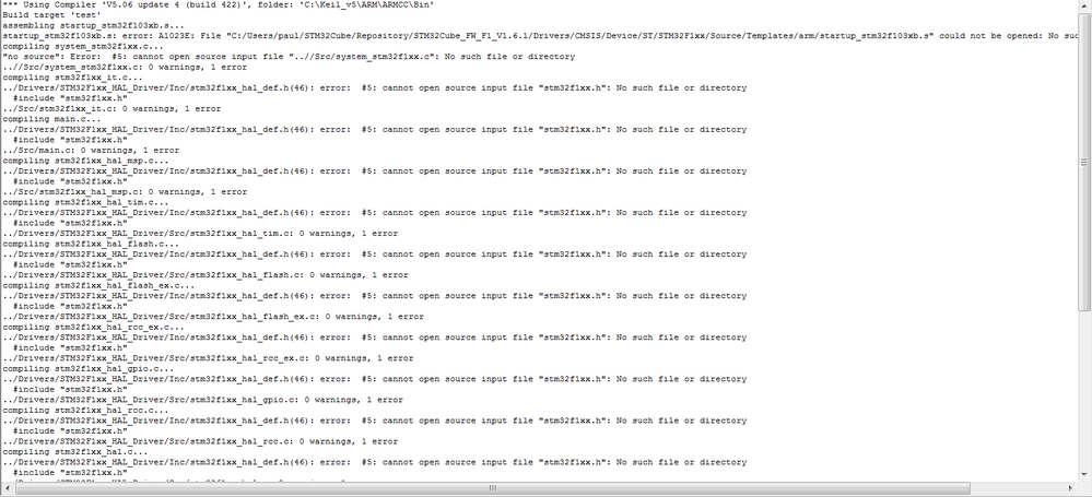

and the bunch of error messages
what is strange is that I changed nothing to the original setup so it should work...

Cube setup:

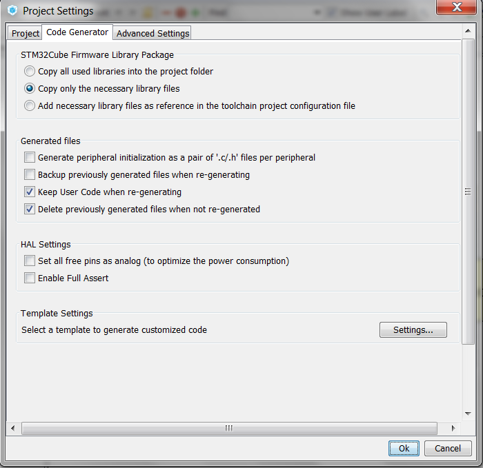

Edit: and now it's working well the second mistake was here:
I copied only necessary library and it's good
