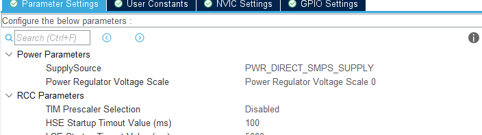

I'm building several projects based on STM32H745 and upgraded to STM32CubeMX 6.8. Upon doing so, VOS0 no longer is an option when using PWR_DIRECT_SMPS_SUPPLY:
6.7:

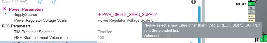

Now with 6.8:
Of course, this changes all the peripheral speeds and causes many problems with existing applications. I don't think this is correct.

There was an issue in the previous STM32CubeMX v6.7.0. It shouldn't have allow SMPS with VOS0.
STM32CubeMX v6.8.0 is following the device datasheet.
On STM32H745, VOS0 cannot be used with SMPS.
This is specified in the datasheet.
See section 3.5.3 (extract below):
Run mode (VOS0 to VOS3)
– Scale 0: boosted performance (available only with LDO regulator)
– Scale 1: high performance
– Scale 2: medium performance and consumption
– Scale 3: optimized performance and low-power consumption
