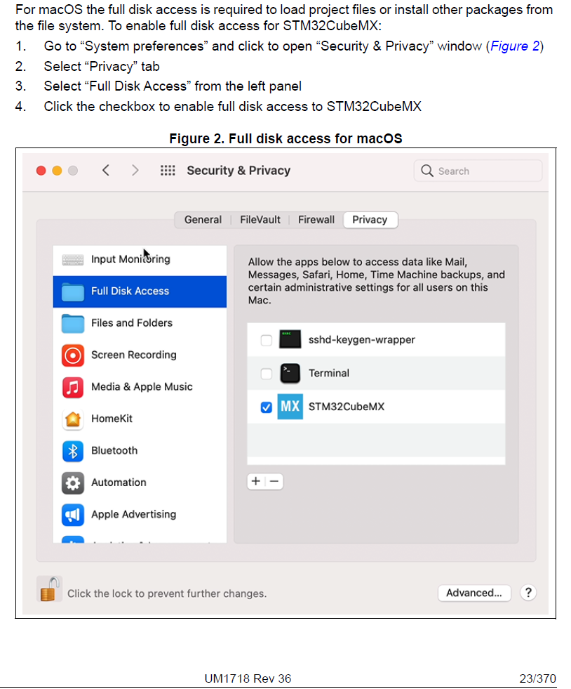

Hi @Andrei Chichak ,
Can you please apply the following solution extracted from the CubeMX UM1718:
Let me know the result.
Regards,
Aymen.

2022-01-10 11:03 PM
2022-01-12 1:42 PM
...IS THE CORRECT ANSWER!!!
Thank you @Aymen CHAKROUN , you are absolutely correct. My system preference pane had STM32CubeIDE and not STM32CubeMX.
The drag-drop that you show in your video was just what I needed.
Thank you again.
