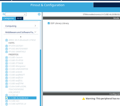

2024-07-16 3:41 PM
In case this helps anyone else, there are two steps required to use the DSP library.
To say that the requirement for the second step is a bit confusing would be an understatement. It would seem to me that enabling this component should be the default when the software pack is selected, considering it is the only option available for that component.
