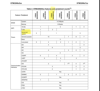

Hello @Thomas_N
Thank you for posting!
Actually, after checking, as mentioned in DS14791 Rev. 7, only one Advanced Control Timer is supported for this part number, in this case only TIM1 is supported.
KR, Souhaib

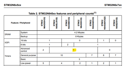

Hello @Thomas_N
The STM32N645B0 have only 1 advanced control timer (TIM1):
so, the TIM8 does not exist on the STM32N645B0.
Best Regards.
