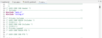

When I generated the source code with STM32CubeMX 6.14.1, my Japanese comments in USER CODE area are garbled. The character code is Shift_JIS. The version 6.12.1 is no problem.
Could you please confirm and modify ASAP?

I've generated the project throw the STM32CubeMX .IOC FILE THAT YOU have sent, and I've added the comments you have added. After compiling the code (generated on the STM32CubeIDE V1.18.1), closing the project and reopen it in another workspace, the comment seems to be fine:

I think this is related to the text editor that you are using. I've seen the same behavior with after opening main(before).c file with notepad. But it works fine with the notepad++.
