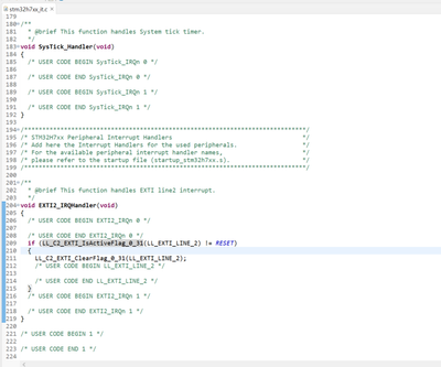

Hello @peterdonchev
Actually I tried to reproduce the issue mentioned above but I found that CubeMX 6.13.0 works just fine and this is my generated code :
