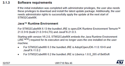

Make sure to follow the section "Installing and running STM32CubeMX" in the UM1718 and check the Java™ Runtime Environment used.

I attempted to install version 6.13.0, which includes the bundled JRE, as mentioned in the documentation you provided.
