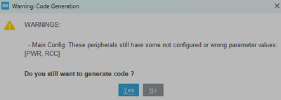

I keep getting this on a STM32U5A5 project, when I generate code, but I do not see anything wrong with the parameters, and after checking, code generation works again.
