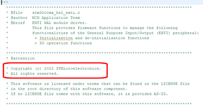

The file headers have a copyright year; eg,
I guess you could use that to narrow down a set of firmware pack versions to download, and then diff to see which one matches?
