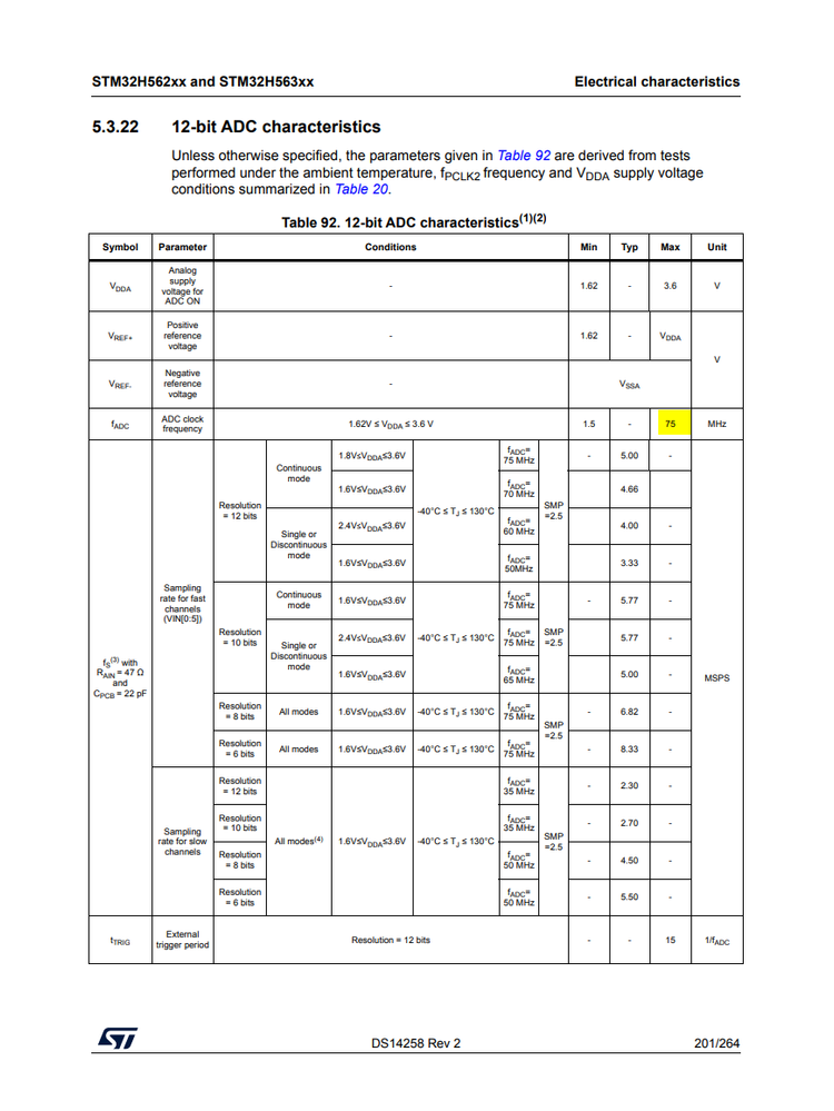

As per DS14258 it is mentioned that the maximum source frequency for ADC is 75Mhz.
This fix was added in the last version 6.10 to ensure that CubeMX will be aligned with the Datasheet.

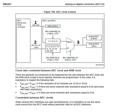

@Souhaib MAZHOUD I thought that this restriction applies directly to ADC clock (3) no to clock from which ADC clock is derived (1 or 2) because 1 or 2 can be further divided to achieve lower frequency of ADC and as for now Cube doesn't let me set 2 frequency higher than 75MHz no matter what divider I set for ADC clock.
Also this restriction can be still omitted by using 1 as clock source because we can set hclk to frequency higher than 75MHz and we can use divider set to 1 and Cube lets us do it.

for my understanding the ADC can work with max. 75MHz, (pos. 3 in your pic from rm);
and input clk (pos. 1 or 2 ) can be divided down to meet this.
so @Souhaib MAZHOUD is also wrong, because 75M is just the max clk for ADC, not for input to the ADC prescaler. He says same as Cube V 6.10. : limit the adc_ker_clk to 75M, but it should just limit the ADC_clk to 75M by setting the prescaler correct.
