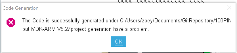

2020-03-04 5:10 AM
Install this version with Java 8 64-bit, still got this error.
2020-03-16 4:17 AM

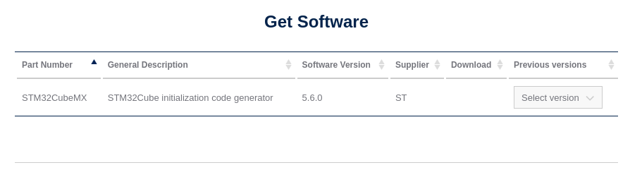

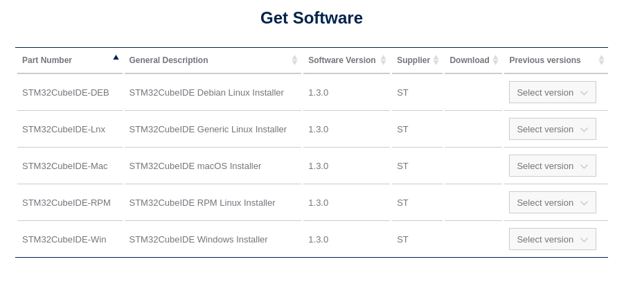

2020-03-17 1:39 PM
I cannot download STM32Cube MX nor STM32CubeIDE.
When I am logged in or click on the link in the email I see no download links:
Deleting cookies made no change.
Any ideas?

2020-05-14 11:11 PM
I tried 5.6.1 again today. When I still used the folder of my old project, the same error showed up. And I copied .ioc to an empty folder and generate the code from this .ioc, the error did not show up.
2020-05-19 7:55 AM
To solve the problem you have to completely uninstall java then install the latest cubeMX 5.6.1 then install the latest java, in the end you can open cubeMX you may see an error message about the java version (it doesn't detect the 64 bit java even if it's installed), just ignore the error, it'll work.
