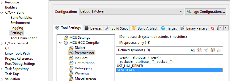

It seems to be still buggy in version 4.1(Winx64, Eclipse Neon 3)
For both compilers (gcc ang g++) the __weak and __packed symbols are defined without quotes:
As a result for c-files the gcc compiler is working fine

Finished building: .../RosRobiF4/Middlewares/Third_Party/FreeRTOS/Source/croutine.c�?�?�?�?
whereas for cpp-files the g++ compiler is failing
Invoking: MCU G++ Compiler
%cd%
arm-none-eabi-g++ -mcpu=cortex-m4 -mthumb -mfloat-abi=hard -mfpu=fpv4-sp-d16 -std=c++0x -D__weak=__attribute__((weak)) -D__packed=__attribute__((__packed__)) -DUSE_HAL_DRIVER -DSTM32F411xE ...
/usr/make/sh: -c: line 0: syntax error near unexpected token `('
/usr/make/sh: -c: line 0: `arm-none-eabi-g++ -mcpu=cortex-m4 -mthumb -mfloat-abi=hard -mfpu=fpv4-sp-d16 -std=c++0x -D__weak=__attribute__((weak)) -D__packed=__attribute__((__packed__)) -DUSE_HAL_DRIVER -DSTM32F411xE ...
make: *** [Application/User/Common/Communication.o] Error 258
Obviously the g++ compiler needs the quotes ...
