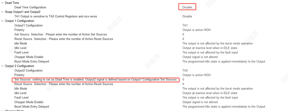

在使用最新版本的CubeMX 6.17.0 配置STM32G474QETx系列的HRTIM时,Dead Time明明没有启用,但是显示TA2的置位输出源无法配置。

Dear @zhengjy926 ,
Thank you for the valuable issue reporting, we logged it in our Internal system with #0059190 Case, and our teams will be back to you.
Regards,
STOne-32.
2026-03-09 12:37 AM
Hello @zhengjy926
Further to what has been mentioned by my colleague @STOne-32 , this issue has already been identified and escalated to our development team under ticket 222461 and it will be fixed as soon as possible .
Please find below a relevant link that discusses the same issue:
Stm32cube MX Hrtim G474x 6.16.0 Bug Report - STMicroelectronics Community
I will keep you posted with updates.
THX
Ghofrane
