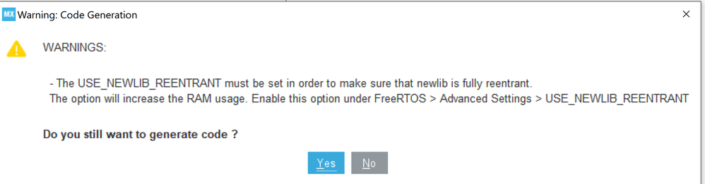

10:13:02 Build Finished. 0 errors, 0 warnings. (took 10s.115ms)I do get one warning when generating code:
2021-08-27 1:24 PM
I have the same warning when I generate the code but the code doesn't built properly. But when I a build a project for stm32f407-discovery (with freertos on STM32CubeIDE v1.7.0) it works properly. What do you mean when you say ".. on the latest version"?
