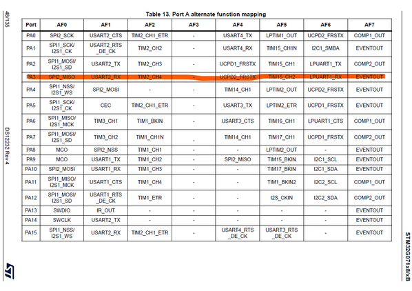

It says that pin PA3 is positive comparator input. When it isn't. Look here

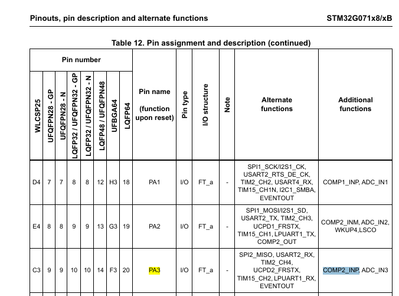

This is what the datasheet says.

Hello.
Comparator is an additional function. Not alternate.
