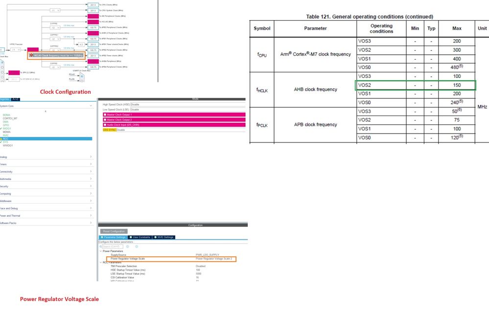

I have an IOC project attached which produce total garbage.
This project was oroginal made to use HSE 8MHz quartz and LSE 32.768KHz quartz. The I changed to use HSI and LSI an there was clock errors which I couldnt se what it is. I made the mistake to use clock resolver (most useless function in Cube) then I had total garbage (the attachment).

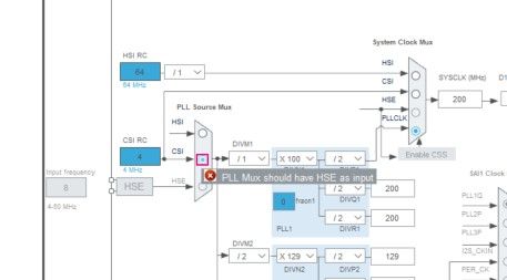

1.) When I select HSI or CSI as clock source, I get error that I have to use HSE as clock even when HSE is disabled??????

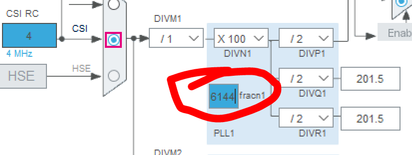

2.) When I select whatever, divide by x to get 4MHz, Multilpy with 100 then devide by 2, I get a sysclk of 201.5. The calculator calculates wrong. Where comes the 1.5MHz extra????
3.) The I tried to select HSI as source and wanted to adjust dividers and multipliers to get 400MHz sysclk but its not possible to do thst because it changes all the time the values what I never asked for it.
4.) When I produce the project. The result will not work at all because in the TIM7 ISR there is empty and there is no call to clockl ISR function. The system hangs after HAL initilization becaus only the TIM7 ISR is called and because of missing of the call to ISR function, nothing else will happen except the ISR call. System is dead. It was also happened that there was no TIM7 ISR generated at all.
The extra 1.5MHz comes from the fractional value, which is not zero.

Backing to same Data Sheet mentioned above > 3.41 Universal serial bus on-the-go high-speed (OTG_HS):
"USB OTG controllers require a dedicated 48 MHz clock that is generated by a PLL connected to the HSE oscillator".

- I've set the franc1, franc3 to 0.

- I've changed the PLL Source Mux to HSE (after selecting Crystal/Ceramic Resonator for HSE) and set HPRE set to /2, DIVQ1 to /4 and DIVQ3 to /5 accordingly.

Moreover, in the subject of of the "PLL Mux should have HSE as input" error, selecting RC48 as an USB clock source can also clear this error.
In fact, for USB application, the internal clock source is not precise enough: To achieve a High-Speed communication, a high frequency clock is required. So the USB clock is sourced from the HSE clock.
Thus, if you're using USB in your project, it is preferred to use HSE clock source for best accuracy since RC48 clock does not technically guarantee the clock stability required for USB use.
RC48 can be good enough, hence it can be used as USB Clock source.

First of all, I didn't knew that I can change the fraction. This is a missed information in Cube that things which can be changed and thing which cant be changed are displayed in exactly the same way.
I know, there are missconfiguration in this file because the problem happened middle of design phase but explain me please why I have to use External crystal for my clock? There is not external crystal. Why I can neither use CSI nor HSI??? The clock source was a missconfiguration which I changed back.
Please also see what happens when you change for example to CSI. The blinkung of almost everthing hints to understand the reason and during this time you can only wait. You cant do anything because the blinking blocks all comboboxes so that you cant change the in the right way. A messagebox would help a lot more. But anyway, I never changed the Power Regukator Voltage Scale. Why its wrong? Who/what change that to the wrong value.
My main problem is that I dont have an external crystal and I cant use this configuration at all.
2021-06-02 6:42 AM
An HSE is required to satisfy the timing requirements of USB in OTG mode. The CSI/HSI is not accurate enough.
