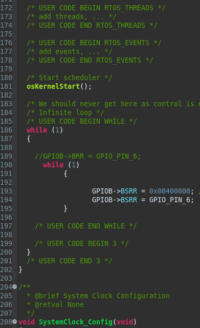

Is there a way to "heal" or tidy up the layout of main.c? A tool or button that can rearrange User code and while code sections? Recently every save of the project's .ioc file results in a closing brace "}" getting deleted in the main.c file. Has the "User Code begin while/end while" to be outside of the while loop or inside? And begin user code 3/end user code 3 outside of the main.c body or inside?

Thanks. But your example would help better, if it only had one while loop. This way it is doubly confusing.

ok, so just make a new project in your IDE, name test_1 , make a clocktree without errors (maybe auto is doing it), generate code.
then you see a 100% new and empty code as yor reference. (needs about 5 mins. )
