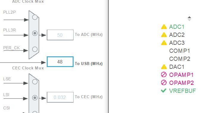

Was old project, works well, need make minor changes with not related to ADC functions, not look press "migrate" to latest version. was confused all ADC operations fault. when check what wrong, found ADC lost clocking.
Take new computer, install clean last version of Cube IDE 1.9.0, make new H750VBT6 project.
look on the clock - ADC clocking tab gray color.
enable ADC - look again, again gray color
Also dissapear "clock prescaler" setting in the ADC settings

Even if i force copy old sourse code, with latest libraries, ADC dead....

Hi @AGord.2 ,
That is a known limitation already confirmed in this question. Sorry for the inconvenience it created for you.
We expect it to be fixed in coming STM32CubeMX release.
-Amel

Manual remove fw package 1.10 not helps
manual edit ioc file
ProjectManager.FirmwarePackage=STM32Cube FW_H7 V1.9.0
anyway pushing to 1.10 and ADC doesnt work (havent any clocking functions to ADC, but all what need was present inside Ioc)
only after this changes in the ioc file
MxCube.Version=6.3.0
MxDb.Version=DB.6.0.30
stay work as expected.
anyway, it not allow make new H7 project with fw package 1.9, where 1.10 are dead.

I've checked your file, there is some problem with 1.9.0. My STM32H750 project shows similar behavior with ADC clock grayed out when migrated from 1.8.0 to 1.9.0.
1) uninstall CubeIDE v1.9.0
2) install CubeIDE 1.8.0 (st-stm32cubeide_1.8.0_11526_20211126_0815_x86_64.exe)
3) don't forget to check marking of your STM32H750 mcu (REV Y or REV V), set revision in stm32cubeide: SystemCore → RCC → Product Revision → rev.Y / rev.V

Thanks for information about core, i not know about it.
Hope ADC clocking bug will be fixed in the next package of FW for H7. All time button "migrate" like bomb...
