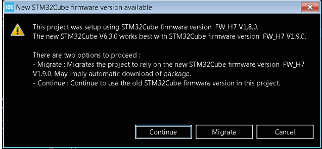

When going to open my project's IOC file, I am presented with the following options:
If I select "Continue", the CubeMX perspective is blank. If I select "Migrate", the CubeMX perspective is viewable.
Isn't the older version supported?
Any idea what the effort is to fix all of the issues a "Migrate" will do? This is not good time for my project to be dealing with this.

Hello @scottSD ,
Thanks for your feedback,
You're right, issue is under analysis and it will be fixed.
We're deeply sorry for any inconvenience that may have caused..

@Khouloud ZEMMELI
I ran across this again (in another one of my projects). I realize that it is a recently reported issue but am wondering if it has gotten any attention.
