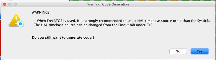

I tried doing this on an actual machine without docker, but then sometimes I would get a popup window during the generation process that requires user intervention.
Such window might pop when you enable FreeRTOS and select SysTick as the HAL timebase source:
This is a problem since the generation process is halted until the user presses a button, which is unacceptable for automated CI environment.
