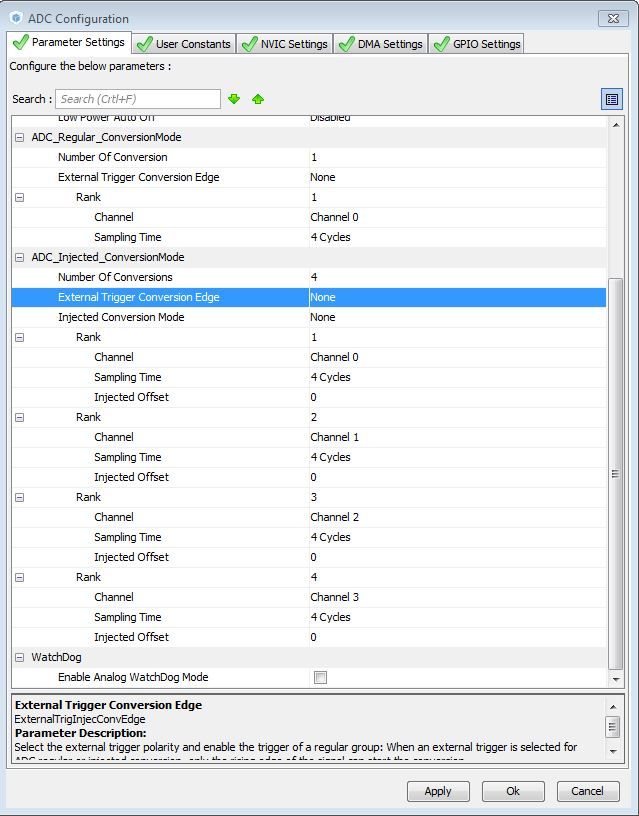

Hi. I have similar problem with STM32L152RBT6.
Generated code is/**Configures for the selected ADC injected channel its corresponding rank in the sequencer and its sample time
sConfigInjected.InjectedChannel = ADC_CHANNEL_0;
sConfigInjected.InjectedRank = 1;
sConfigInjected.InjectedSamplingTime = ADC_SAMPLETIME_4CYCLES;
sConfigInjected.InjectedOffset = 0;
sConfigInjected.ExternalTrigInjecConvEdge = ADC_EXTERNALTRIGINJECCONV_EDGE_NONE;
HAL_ADCEx_InjectedConfigChannel(&hadc, &sConfigInjected);
But this strings are missed:
sConfigInjected.ExternalTrigInjecConv = ADC_INJECTED_SOFTWARE_START;
sConfigInjected.InjectedNbrOfConversion = 4;
This is adc configuration window
