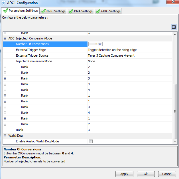

I'm using STM32CubeMX for a STM32F205 MCU.There is a problem with the use of the ADC1 configuration, regarding Injected Groups. 1/ when I choose the number of injected conversions, lots of intrusive 'ranks' display on the frame (normally, you should have the same number of visible ranks than the chosen number of conversions). I join a screenshot. Note that the generation of the code is consistent with the display - but then it generates a wrong code, that doesn't work, and that need to be manually changed. 2/ the number of injected conversions is missing at the code generation, and then the configuration of the ADC1 is wrong, the register JSQR is not filled, and it doesn't work. You must add it manually too. ''sConfigInjected.InjectedNbrOfConversion = 1...4''.Idem for ADC2.

Thanks for your update.But it still does'nt work, even if some bugs have been fixed. Regarding my first post, problem 1/ is fixed. But problems 2/ and 3/ are still there : the number of injectedChannels is set at 4 by the generated code, even if I select an other number in the config tab ! Moreover, even if I set the 'Injected Conversion Mode' to ''none'' , the JAUTO bit is set by the generated code. To finish, why don't you allow a ''0'' number of regular channel conversions ?In my application, I don't need regular conversion, but the code is even though generated and it is useless and could be a source of problems.So, please, fix these 3 things because at now, I can not rely on the automatic generated code. When could it be done ?Regards,2014-06-25 12:21 AM

Fixes for these issues will be delivered in STM32CubeMX 4.4 that should be posted next week. Best Regards2014-10-17 5:33 AM

For issue #1 its also present in ver 4.5.
I saw a work around that if you lower the ''number of conversion'' to 1 and then increase it back to the number that you want, it will fix the issue.
Good luck.
