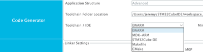

If I change the tool chain from STM32CubeIDE to for example EWARM the error is not present.
