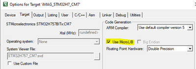

2024-08-19 12:21 AM
Try with enabling microLib option
Thanks & Regards
