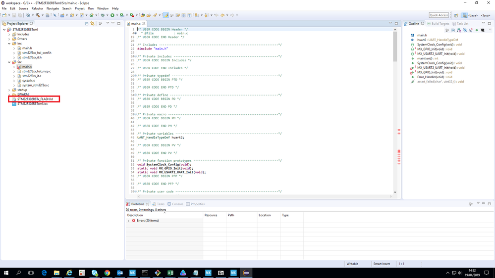

CubeMX 5.1.0 and STM32F302 every time a project is re-generated the
STM32F302R8Tx_FLASH.ld file is empty.

If i delete the LD file before the project is re-generated then all works fine.
This is probably a mistake from the cube. Are there cube programmers present or is there any ticket system for bugs?

I experience this problem with CubeMX 5.1.0 too. First time project is generated OK with linker script present and being correct. If I regenerate project (not touch the *.LD script), CubeMX makes the *.LD file empty. Only if I delete the LD file then it regenerates okay.
With empty LD file the built binary is 8 bytes and is basically empty..
This is definitely a CubeMX bug.

I have this issue from time to time. Both on SW4STM32 v 2.8.1 and 2.7.0 using CubeMX 5.1.0 rc6, package F4 v1.24.0 (i use F446 MCU)
The issue is that after REgeneration of project (not initial, but 2nd or 3rd, from time to time it shifts) the LD file becomes empty. File exists but empty. And after next regeneration is stays empty until I delete it. Then CubeMX regenerates it okay.
You should try it multiple times, it doesn't do that EVERY single try.
