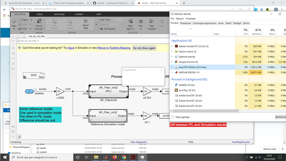

I tring to test the IIR-Filter project from STM32_MAT-TARGET on my stm32f429i-DISK1 board with sw4stm32 toolchain but i've some problems ( used many time all the steps of STM32_MAT-TARGET_HandsOn_v1_0.pdf) but for me the biggest issue is the freezing when simulink try to open stm32cubemx (probably at clockwizard start).
Java not work and only after i kill the process stmCube work, but without the settings...

i don't know how is possible, but the issue with java and cubemx is come back! :loudly_crying_face: stm32cubemx stop run on the clock wizard.

For the java freezing issue the only solution is kill java and set manually the clock and the other parameters.
