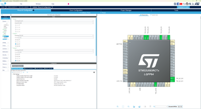

I ran a test using MX v6.16.1 and was able to enable the TSC, as shown below.
Could you please share more details about the issue you are facing, or attach your .ioc file so that I can review your configuration and help identify what went wrong?
THX
Ghofrane
THX
Ghofrane
