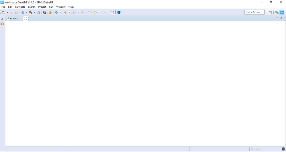

After an Update from V1.0.2 the V1.1.0 works fine, but when I restart the program, it never open. I try to restart the computer, re-install de SW (downloading directly from the web), if I re-install a previous version (the V1.0.2) the program open.
Also I saw the task administrator, in details (in V1.1.0) the task STM32cubeide.exe (with 871492k of memory) apears but not the process.

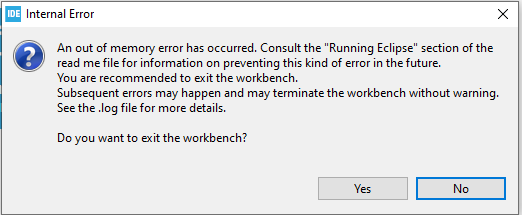

when I create a new project in V1.0.2 says "Java heap space" and close the IDE

I Install the CubeMx Software, and I realized that I had the 32-bit version of Java by an error message. so I installed de 64 bit Version, and works ok. I assumed that it would also be solved in the CubeIDE, but nothing. just doesn't open correctly.
At the moment, I can work with the external CubeMx. but I leave the restlessness to the community and STM. I will be attentive.
