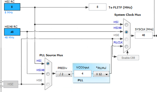

,I check the Clock configuration tab for the two *ioc files and the same Clock settings is usedfor the two projects : HSI48 to
drive the system clock.
so it is expectedthat you have the same generatedSystem Clock Configuration for two test cases.now to use the HSE bypass:
Enable the HSE bypass in Pinout tab(already done)
Then in the Clock configuration tab select HSE as source to drive system clock :
-Nesrine-

Doh! I completely missed the clock configuration step. Thanks Nesrine for the very speedy turnaround on this. I'm now happily clocking on the 8MHz HSE clock.
