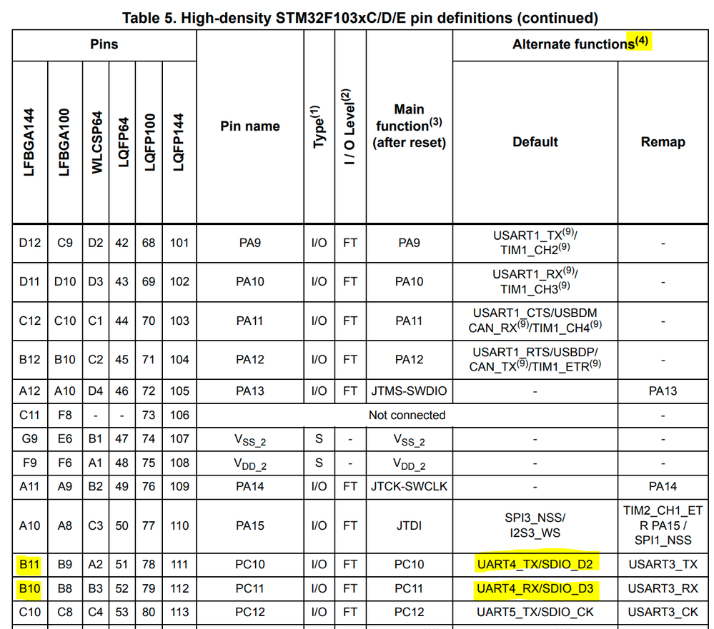

2021-05-25 5:39 PM
STM32F103RCT6 LQFP64.
2021-05-25 5:57 PM
2021-05-25 6:52 PM
The STM32F1 family assigns pins on a per-peripheral basis rather than per-pin. Less ancient families do this on a per pin basis. So even though you aren't using SDIO_D2, it shares its functionality with UART4 and you can only have one enabled per the datasheet.
