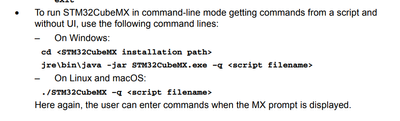

The main reason to raise a concern is because the behavior of the CubeMX tool contradicts the user manual (UM1718).
It explicitly says to run CubeMX "without UI", use this command. However, the said command pops-up a window which is not expected.

I agree, the tool should exit gracefully with error codes instead of popping up windows when invoked in non-GUI mode. Hopefully the issues are resolved soon :) We can always try !
