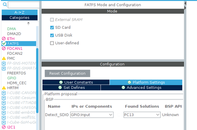

for Platform Settings Tab ,
see:
and give it, what it wants (a pin, input ) to see sd-card in or not (sd-card holders usually have a switch ).
"clock" - i never seen, maybe you have bad clock setting for sd-card module.
I use 100M , and div1 (/2) , so card gets 50M, typical max. clock for sd .
And set all pins to card to medium speed, with pullups on. Then it will work. :)
