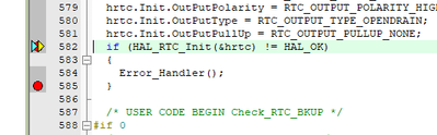

After HAL_RTC_Init() call from main;  RTC_TAMP_IRQHandler is getting called continuously.
Time and alarm is configured after  HAL_RTC_Init(). which is not even called.

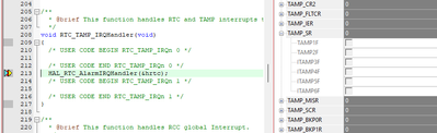

Set a breakpoint in RTC_TAMP_IRQHandler. Examine the state of the RTC and TAMP to determine why it has called.

When Interrupt is triggered, RTC_SP flag only WUTF in enabled rest all are zero. For TAMp_IER register all 6 interrupt seems to be disabled.

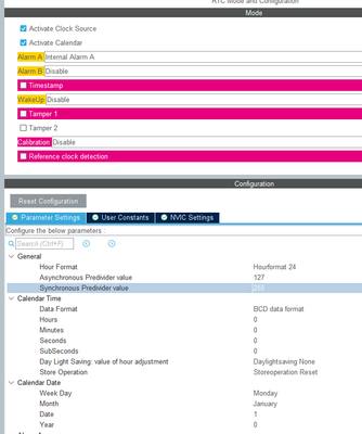

Hi, I have not configured auto wake. I am using Cube Mx for initiation. I have enabled Alarm A but even before Init of Alarm interrupt is getting triggered..

Can you read the status of the TAMP_SR register when this issue happens ?

TAMP_SR all 6 flags are in Reset state.
  Here are my CubeMx settings. I have not enabled Tamper Pins i assume.
After this RTC init before configuring alarm itself my function jumps to  RTC_TAMP_IRQHandler
