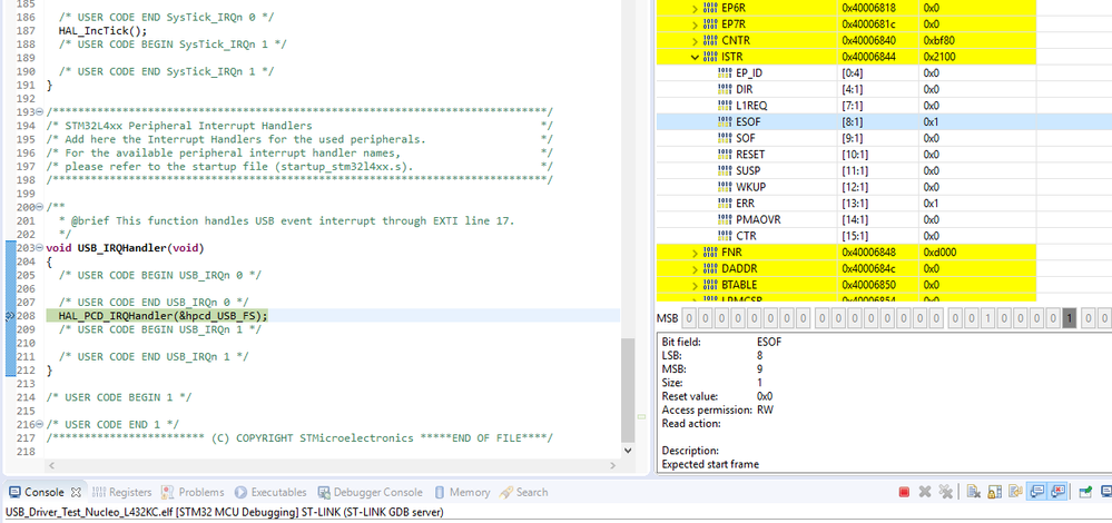

Now when I connect a 1.0 A Apple USB charger some strange behavior occurs. Right after initialization with MX_USB_DEVICE_Init(); the USB interrupt handler gets called with the ESOF and ERR flag set in the ISTR register. The interrupt now gets triggered continuously and the CPU is stuck in the interrupt handler.

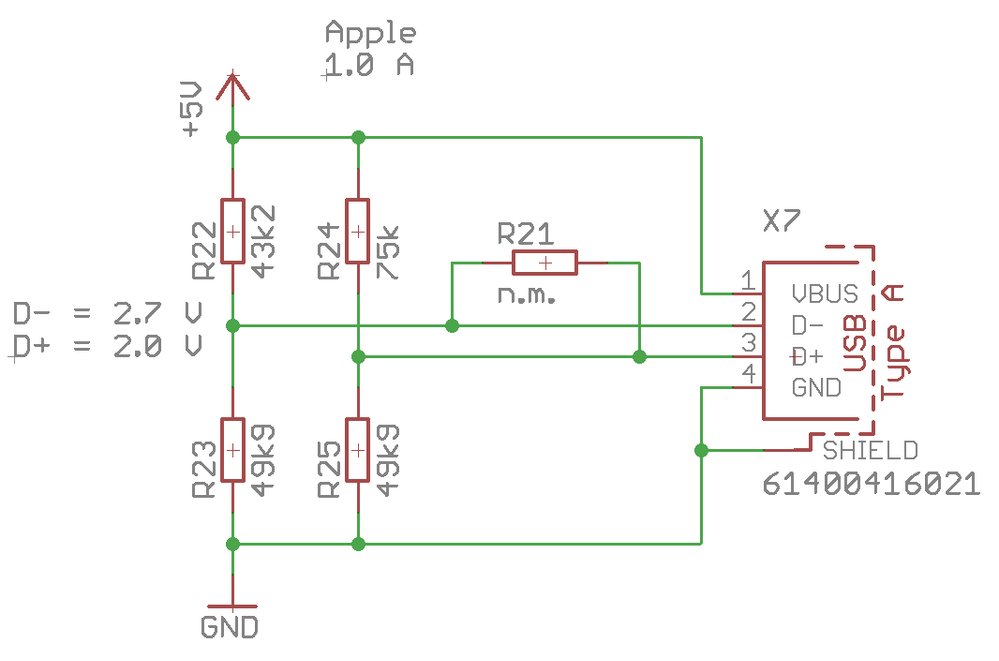

The Apple charger is emulated with the following circuit:
For testing, I connected D+ to a laboratory power supply and varied the voltage. The software gets stuck in the interrupt if D+ is between 1.6 V and 2.4 V. Below 1.6 V and above 2.4 V no continuous interrupts occur, USB initialization is executed as expected.
If the startup is performed with D+ @ 2.0 V, the interrupt does immediately stop from occurring if D+ is regulated to less than 1.25 V or more than 2.4 V. So you have a small hysteresis at the lower voltage limit.

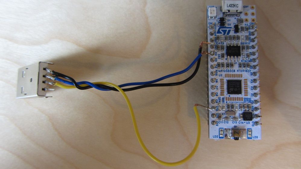

If you like to reproduce the issue, you can use the attached STM32CubeIDE-Project and a NUCLEO-L432KC board.
Attach a USB connector like in the following picture or use the resistors from the previous schematic.

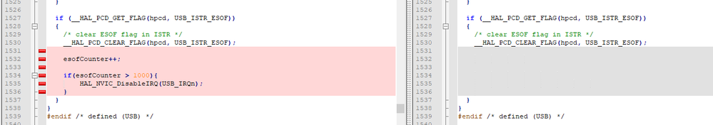

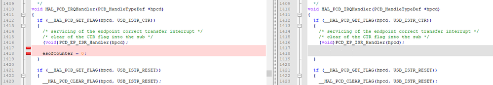

My current solution is a modified stm32l4xx_hal_pcd.c (see attachment). In the interrupt handler the ESOF interrupts are counted and if the counter reaches 1000 the USB interrupt gets disabled. The esofCounter is set to 0 in the CTR-interrupt. Just to be safe, because I don’t have so much experience with USB to assess how many ESOF-interrupts can be expected during normal operation in the long run.
