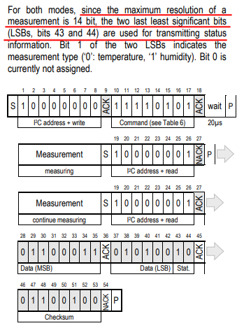

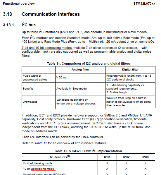

I tried to communicate using I2C function in STM CUBE MX, but the sensor seems to communicate with 13bit... MX only supports 10bit....Please help....

"the sensor seems to communicate with 13bit... MX only supports 10bit...."
What do you mean by that?
According to the SHT20 datasheet, it uses standard 8-bit data size:
why do you think so? According to the data sheet, the sensor has a 7-bit I2C target address and normal, byte wise data transfer.

@Damdori "MX only supports 10bit...."
Are you confusing data size with the addressing modes there?
2022-07-07 11:29 PM
Ah, I guess I misunderstood.
