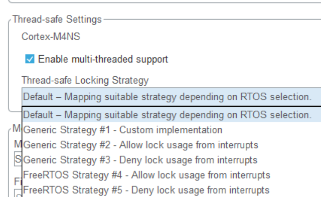

In the release notes of CubeMX 6.3.0 it says:
Added thread-safe locking support. It can be enabled or disabled in [Project manager]>[Project] Thread-safe Settings
In the Project settings tab there's a new item:
But it is not mentioned anywhere else. Can ST share documentation on this?

Any update? I also did not find documentation on this.
Regards,
2021-12-09 9:39 AM
See AN5731, just published in Nov.
