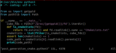

It's an old thread but I put my findings here since I found no documentation.
Tested with cubemx v6.15.0 under linux:
If script name has ".py" extension, it tries to run ["py", "yourscript.py"] which fails since there is no "py" executable by default on ubuntu.
If script name has another extension, it runs ["python3", "yourscript"] (without arguments, without meaningful working directory).
It is subject to change, but version 6.15.0 and cmake generator keeps some files opened so we can deduce generated code path from it.
Another way is to parse last logs from $HOME/.stm32cubemx/STM32CubeMX.log and retrieve path from "CodeEngine... Generated code: /path/to/project/Core/Src/main.c" entries.
