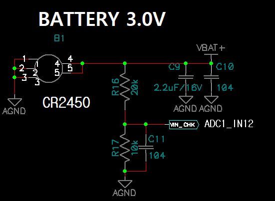

My maximum voltage input is 3V. It is connected to ADC in through 20k/10k voltage divider.
3V *10/30 = 1V
But I get 0.595 V.

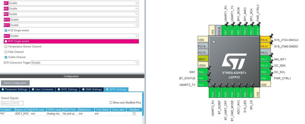

To enable internal reference voltage, I have checked Vrefint Channel in ADC

> If Vref = 1.2, then I should get 1.2 V in Vref pin but Vref pin voltage is 0.535 volt.
What "Vref pin"?
There is no separate VREF+ pin on 'L422KBTx, it's connected to VDDA which you are supposed to connect to analog supply voltage. (The only 'L422 with separate VREF+ pin is in WLCSP36 package).
Also, in 'L42x, there is no VREFBUF module i.e. you can't output the internal reference voltage.
