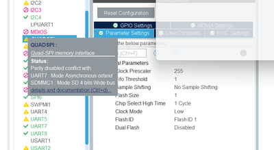

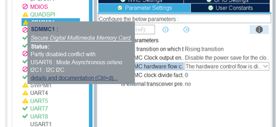

2- Apart from report, there are other warnings as seen in the IDE GUI.
SDMMC1 has yellow warning that is:
QSPI has warning too:
What does these hints mean, how to find out what resource is in conflict, e.g. how could UART7 Mode Async and effect QUADSPI, is it some clock related thing? or DMA?. How to resolve

Yellow exclamation points do not indicate errors or things that need fixed. They indicate that some or additional features cannot be enabled due to pins in use.
As for how much you can have in use at the same time, it depends on what exactly you want and how many pins you have available. Peripherals are only available on a few different pins at most.
For example, in your screenshot, I2C3 cannot be enabled in any mode because its pins are tied up with other functions, so it is displayed in red.
