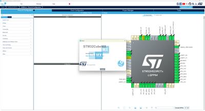

Hello @CLanc.1
Please use the attached .ioc file.
I have already corrected the MMT parameter value, so you should be able to migrate it and open it with STM32CubeMX 6.16.1 and 6.16.0. as shown below.
I will be waiting for your feedback.
