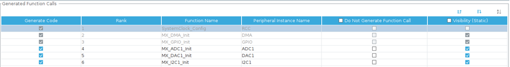

2021-10-23 7:01 PM
After some extra research I have found that it is possible to rearrange the order of the initialising functions under:
Project Manager > Advanced Settings
The top right icons let you move the individual functions up and down which is the order in which they will be generated in main.c
It's not perfect because the default order is still going to cause people to waste hours until they figure it out, but at least it automates the process once the issue is identified.
I hope this will help someone.
