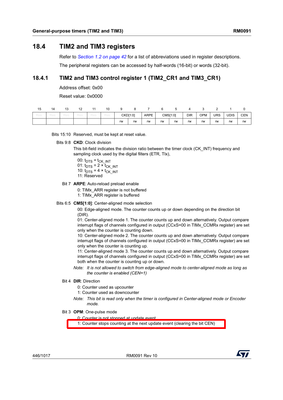

htim5.Instance->CR1 |= (1 << 3);
HAL_TIM_PWM_Start(&htim5, TIM_CHANNEL_1);
I wrote the code like this, but it doesn't work. -> The signal will remain at the High level only.
Do you happen to have an example code?

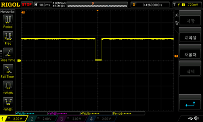

2024-08-05 7:24 PM - edited 2024-08-05 7:31 PM
I'm changing pwm mode and opm mode using external buttons.
When entering opm mode, keep high level and generate pulse. I want to keep low level and generate pulse.

2024-08-06 3:50 AM
Then you have either use the other PWM mode, or invert the output signal using TIMx_CCER.CCxP.
You may need to change also TIMx_ARR and TIMx_CCRx between the PWM and one-pulse mode to fit your expected output waveform.
