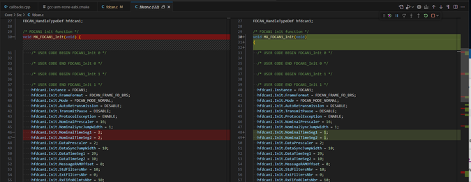

So tha problem is that during the cubemx update the NominalTimeSeg parameters were changed.

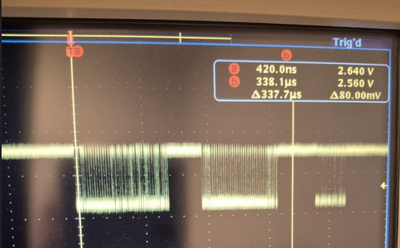

Here you can see how it looks before the update:

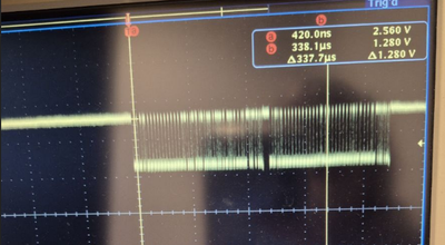

And here it is after the update:

Doesn't your scope have a means to download screenshots - rather than take blurry photos?
2025-01-06 6:49 AM
No, it’s not possible for now. If it were, I would have done it. Have you faced the same issue with CAN? If not, I’ll just continue solving the problem myself. I don’t need help with remote debugging :)
2025-01-06 7:42 AM

2025-01-06 8:55 AM
I don’t think the post you mentioned has anything in common with my issue. The Nominal Time Seg1 and Nominal Time Seg2 were correct and set to 2. However, after I updated the CubeMX version from 6.12.1 to 6.13.0, these parameters were magically changed to 1 :)

Hello @tuo ,
On STM32CubeMX 6.12.1 the initial value of Nominal Time Seg1 and Nominal Time Seg2 are equal to 2.
This issue is fixed on STM32CubeMX 6.13.0 under this internal ticket: 185818.
Therefore, after the migration you find that the Nominal Time Seg1 and the Nominal Time Seg2 are equal by default to 1.
Thanks.
Mahmoud
2025-01-07 1:09 AM
The problem is that 2 - is the value that I set and I needed it to remain 2, not 1.
