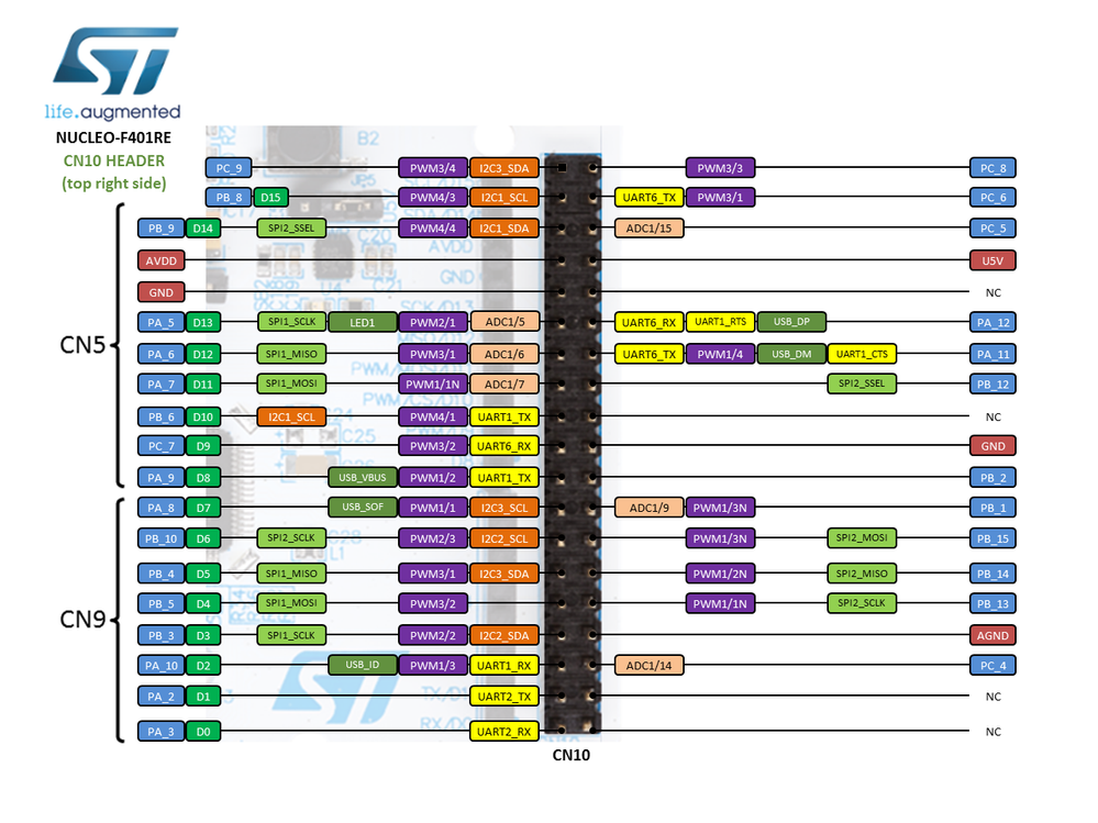

I've been struggling for a while now to start the SPI1 protocol on the Nucleo-401RE. According to the datasheet, SPI1 is connected as follows,

}What exactly am i missing? I checked several times that my pin connections coincide with what the datasheet says. But i still can't see anything either on the oscilloscope or logic analyzer.

Hi
have a look at the schematic at https://github.com/Nastrawww/STM32F401RE/blob/main/NUCLEO-F401RE_Schematic.pdf
Look at sheet 4 there are some solderbridges (SB44) Take a look at the manual to see what the
bridges do. I has had an ssue with the L412 there are solderbridges they are closed by default and shorted
I²C and SPI.
hth
