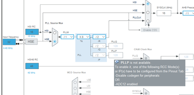

I'm working on page 30 of the STM tutorial for the B-G474E-DPOW discovery kit at this link
I get this warning when I try to follow the directions
Can someone explain how to fix this so I can move to the next step in the tutorial.
I've tried looking up codegen in the reference manual and also how to manipulate ADC12.

Hello @decook1110
In order to set the [PLLP Clock] or [SYSCLK] as source Clock for the ADC12 or ADC345, just change the clock Prescaler to Asynchronous clock mode in the ADC_Settings.
Best Regards.

Hello @decook1110
Best Regards.
STTwo-32

Thanks for the work around, that fixed the clock so I can move past that,
